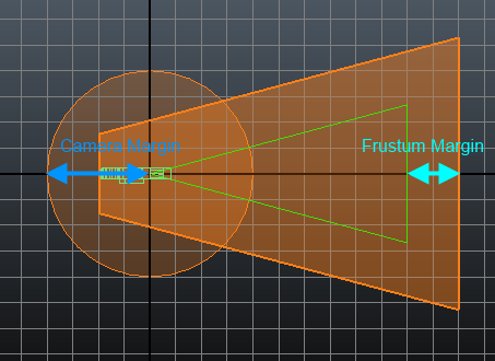

Rendering Only What's Viewed by the Camera (+margin)
Even if the procedural rendering approach only generates Entity geometries when they're required / hit by a ray, it's not uncommon to have Entities really far from the camera getting generated due to diffuse / shadow ray bounds. Thus, in certain situations, it's possible to generate only the Entities which are close enough to the camera frustum.
Notice that this feature is REALLY efficient to lighten the render times as soon as reflections, color bleeding don't have to be 100% accurate.
To base the rendering on the camera frustum, open the Rendering Attributes of the CrowdManagerNode:
The Frustum / Camera margin attributes can be seen as the following:
