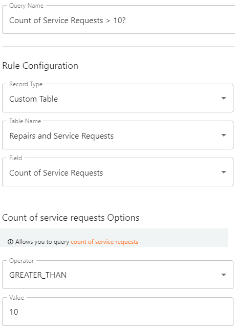

    April 23 | Query data you have uploaded in a custom table.
    For example, you could upload data on the count of service requests, average repair costs, last repair dates, etc., then query this data in a rehab decision tree.
    When configuring your query, choose Custom Table as the Record Type, then select the Table and Field you want to query.
    See also:
    • Import Custom Tables
    • Create Queries and Rules
