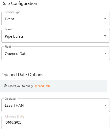

June 25 | Query the event information you have uploaded to Info360 Asset in your rehab decision trees.
For example, you could create queries to find assets that have suffered a particular type of event (e.g., flooding, pipe bursts, etc.) in the past.
You can query any of the fields you mapped during the import process. When creating your query, select Event as the record type, select the event type, and then the specific field you want to query.
