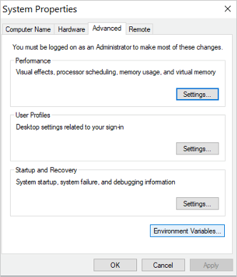

  5. Create a new system environment variable: ORACLE_HOME=C:\Oracle\instantclient_21_3
    1. Open System Properties Advanced and select Environment Variables.
    2. Under System Variables, click New.
    3. Add Oracle details and click OK
      • Variable name: ORACLE
      • Variable value: C:\Oracle\instantclient_21_3 or appropriate version
    Note: This change will apply on new windows but typically doesn't impact existing shell windows.
