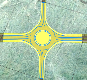

Initial crossroads style Junction Type:
Resulting conversion aftering clicking the Roundabout junction type in the Stack:

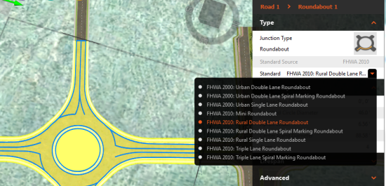

You can change the roundabout type in the Stack. Toggle the Standard drop-down menu. Click to choose a different type.
You can modify roundabout geometry in-canvas or in the Stack.
