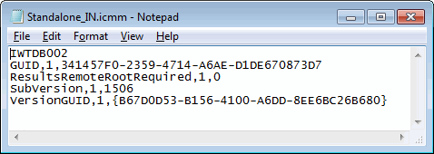

Your Database.icmm is a basic index file that tells InfoAsset Manager where the database data is stored. The contents of the index file will look like:
There is a sub-folder of the folder where the ICMM file is located that contains all your data. The sub-folder name is the automatically generated name highlighted above (string displayed in the GUID row). This name should be unique for all databases. This folder name can be seen on the InfoAsset Manager About Box.
A good strategy is to keep each database in a different folder. Then simply back up the contents of that folder and all sub-folders.
