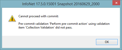

If a pre-commit validation has been defined for the network, then the data is checked against the validation rules for that network and a progress bar is displayed in the status bar at the bottom of the main window. You can use ESC to cancel the pre-commit validation at any time.
If the validation fails, then:
- A suitable message is displayed.
- The network (if it is not already open) is displayed on the GeoPlan, with the network objects, which have failed the validation checks, highlighted.
- The results of the validation are displayed in the Output Window.
- Select the Cancel button to abort the commit operation and close the Commit Changes dialog.
