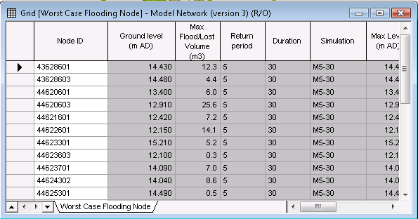

The grid displays:
  • The node or conduit ID
  • The worst case of the selected parameter at that node or conduit
  • The simulation which caused the worst case
  • Return period and duration (if information available from rainfall event)
  • The other summary results for the node or conduit from the simulation that caused the worst case
The following image shows an example of a worst case report for flood volume for nodes included in an InfoWorks simulation.
