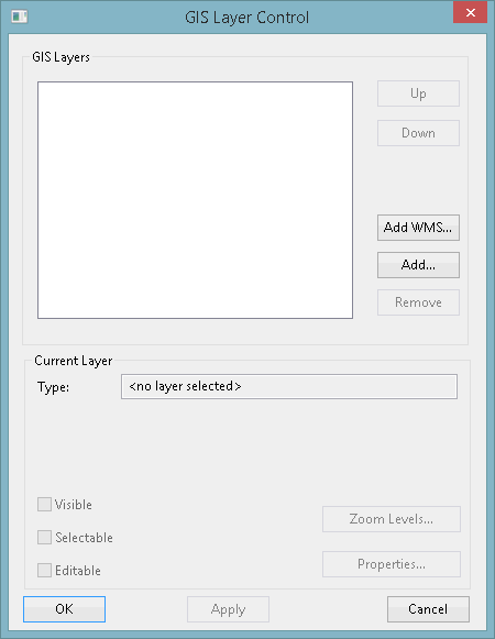

  3. The GIS Layer Control dialog is displayed. The appearance of the dialog and the action to be taken depends on the map control you are using.
If you are licensed to use more than one Map Control, you may want to change the current Map Control. See Changing the Current Map Control for more details.
ArcEngine, ArcObjects and MapXtreme
The screenshot above shows that there are currently no layers that have been added to the network. When some layers are added, their names appear in the white area.

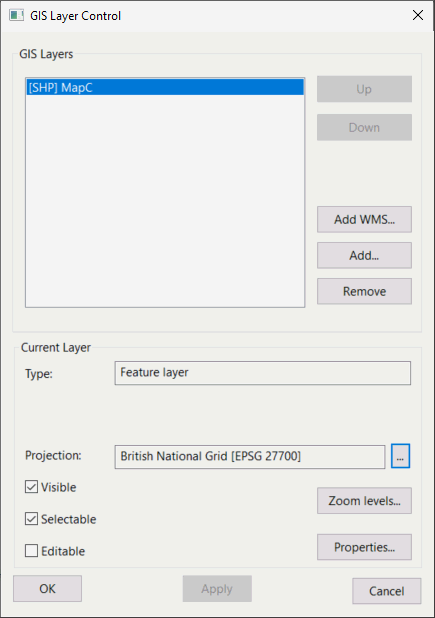

  1. Click Add and a Windows Open window is displayed.
  2. Go to the 'Tutorial Files/Maps' folder in the 'Example Data Directory'.
  3. Select 'MapC.shp' and then click Open.
  4. The Open window closes and a new layer is added to the dialog.
  5. Click OK to save the GIS layer selection and close the dialog.

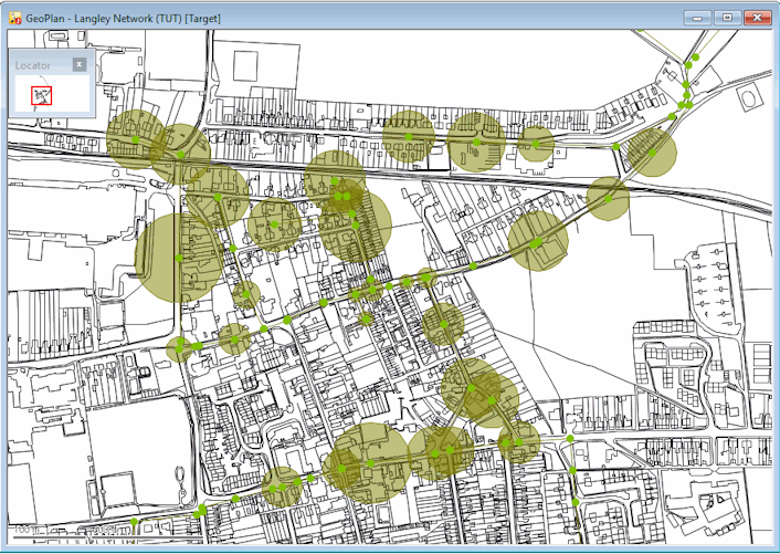

Displaying the Layers on the GeoPlan
Whatever your Map Control, the GeoPlan is redrawn with detailed Ordnance Survey maps behind the network. These maps allow you to see where the network elements are in relation to features such as roads, buildings and rivers.
You may add other layers, in which case the order of layers is as shown in the GIS Layer Control dialog and can be changed.

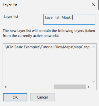

Save the layers as a layer list for future use:
  1. Right-click the 'Layer List Group' in the Explorer window and select New InfoWorks Layer List from the pop-up menu. If there is no 'Layer List Group', right-click the top icon, choose New InfoWorks Model Group from the pop-up menu and a 'New name' window appears. Enter a name for the model group, such as 'Layer List Group', in the window and click OK. The window closes and you can now save the layers to this new group. Note that the model group icon will automatically change to a layer list group icon once the new layer list has been added to it.
  2. In the Layer list dialog, type a relevant name for the list and click OK.
  3. Later, if you have removed the layers from the GeoPlan, you can restore them by opening this layer list Right-click the layer list in the Explorer window and select Open from the pop-up menu or by dragging it into the GeoPlan.
