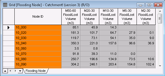

The Flood Volume Report identifies the nodes that would be flooded in particular circumstances. The report lists the nodes in the first column. There is one additional column for each simulation included in the report.
The entries in the grid give the excess volume of water for that node under the conditions represented by the given simulation.
See Grid Reports for information on creating a flood volume report.
