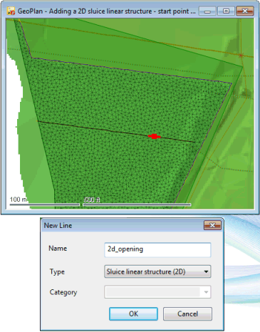

The first step is to add a 2D sluice linear structure into the 2D zone. These structures can be used to present bridge openings or sluice. The 2D sluice linear structure represents an opening of the wall that never collapses during the simulation. We are going to draw a line in the 2D zone and define it as a 2D sluice linear structure:

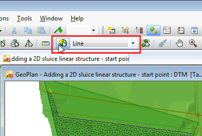

- From the New Object toolbar item, select Line as the required object type. Then select the New Object button
- Draw in a new line as shown in the screenshot below. When prompted, set the name as 2d_opening. It is also very important to remember to set the line type to Sluice linear structure (2D).

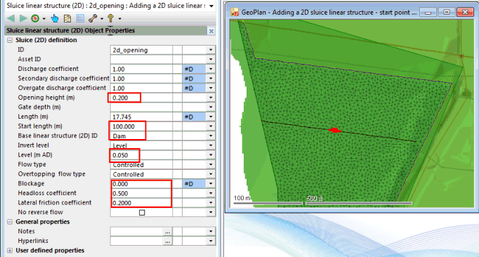

- Next, use the Properties tool
, select the 2D sluice line and set the various parameters required. In particular, set the Base linear structure (2D) ID to Dam. This will link the 2D sluice linear structure to the existing 2D base linear structure. Also set the Start length (m) to 100. By doing so, the location of this 2D sluice linear structure will be moved 100m from the start (as drawn from left to right) of the Base Linear Structure, towards the middle of the 2D wall providing a better presentation as an opening.
- All other parameters should be set as in the screenshot below (Opening height set to 0.2 m, Level set to 0.05 m, Blockage left at 0, Headloss coefficient set to 0.5 and Lateral friction coefficient set to 0.2).

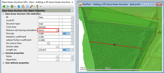

- Next, use the Properties tool, select the 2D base line and in this tutorial, we use the existing 2D base linear structure as a never collapse wall, set Remove wall during simulation to Never and ensure that Porosity is left at 0.

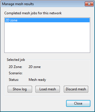

- The 2D mesh can now be loaded into the model. Select Meshing
Load mesh job results… from the Model menu. In the
Manage mesh results dialog, select 2D zone from the list and click on the Load mesh button.
- Click Close to close the dialog.

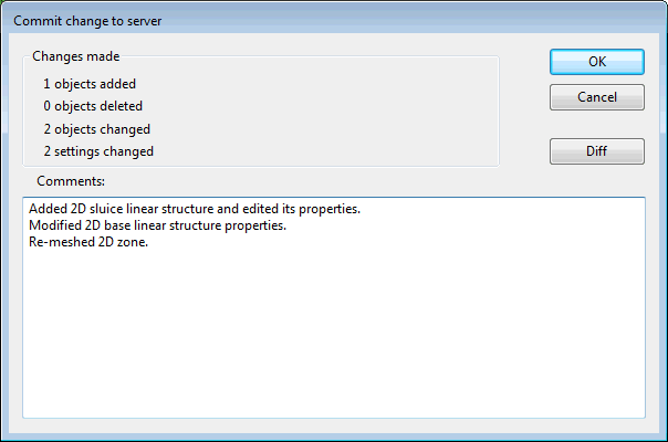

- Changes made to the network must now be committed to the database so that they become available to other users.
- In the Explorer window, right-hand click on the Adding a 2D sluice linear structure network and select Commit changes to database.
- The Commit change to server dialog is displayed.
- Type in any notes as appropriate.
- Click OK to commit the changes and close the dialog.

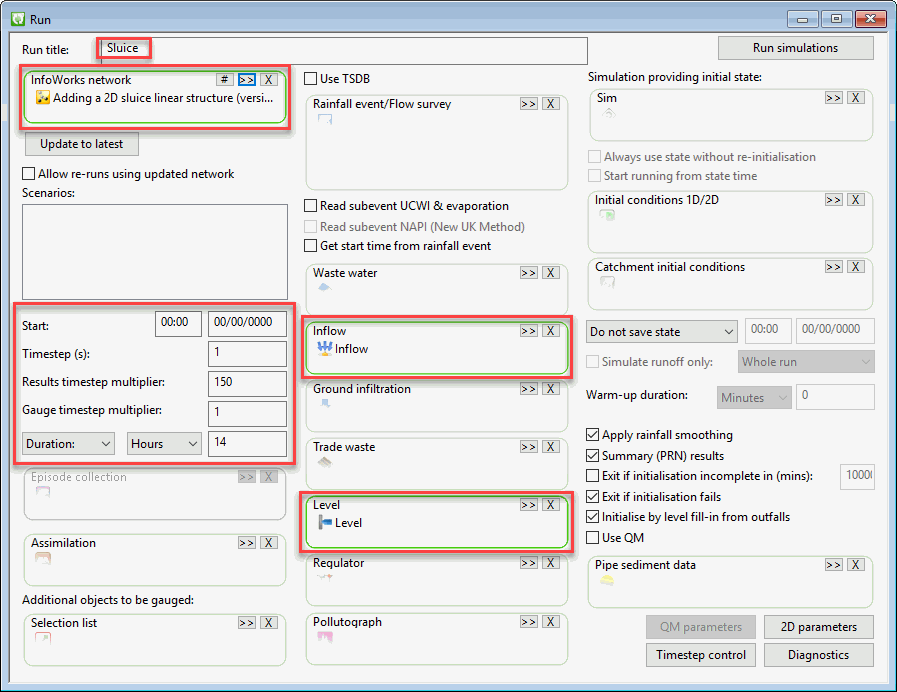

- Create a new run and define the run parameters as shown in the screenshot below:
- Create a new run by right-clicking the Model Group in the Explorer window.
- Select New
InfoWorks
Run. The
Schedule Hydraulic Run View dialog is displayed.
- In the Schedule Hydraulic Run View dialog:
- Enter a name in the Run title (Sluice)
- Drag and drop your network (Adding a 2D sluice linear structure) in the InfoWorks Network drop target.
- Drag and drop the Inflow hydrograph in the Inflow drop target (This hydrograph has been added to the model in step 5 of the Building a river model in InfoWorks ICM mini-tutorial).
- Drag and drop the Level hydrograph in the Level drop target (This hydrograph has been added to the model in step 5 of the Building a river model in InfoWorks ICM mini-tutorial).
- Set the Timestep to 1 second and the Results timestep multiplier to 150.
- Set the Simulation time to 14 hours.
It is worth noting that 1D-2D models will typically have a lower timestep than 1D-only models. In this example we will be using 1 second, but below 10 seconds is perhaps more common.
- Click Run simulations.
- In the Schedule Job(s) dialog that gets subsequently displayed, choose which computer will carry out the simulation (This Computer) and leave the other parameters as they are (store results locally and start the simulation now). Click OK to start.

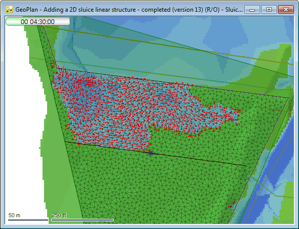

- Once the simulation has completed (the simulation icon in the Explorer window will turn from blue to green and the Job Control window will show a green row with a status of Ended for the simulation) you can look at and analyse the results by dragging and dropping the DWF simulation from the Sluice run onto the main window.
- Drag the DTM ground model onto the main window.

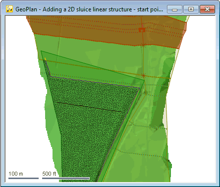

- Modify the 2D zone configured in the 2D Zone tutorial so that low flows and depths have a higher visibility. Please refer to the previous tutorial for more information.
- The two following screenshots have been obtained using the modified 2D zone theme and the same flood theme as described in the 2D Zone tutorial.
Before reaching the opening
After reaching the opening
The simulation has created a large number of results, which you can now inspect. The results of a simulation can be investigated in different ways and the tools available to do so are similar regardless of the network. Please refer to the Viewing Simulation Results 2D Zone topic of the Adding a 2D zone to an InfoWorks ICM river model tutorial for more information.
