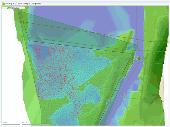

Once the results have been loaded, zoom into the area of the 2D zone and bridge.

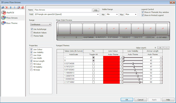

Set up a theme for 'Flow Arrows' on the 2D zone. Create up to 10 red arrows of varying length and line visibility. Do not show arrows for velocities less than 0.5 m/s. Creating exact settings is not important for this part of the exercise, but a suggested set of parameters is shown below.
You can experiment with different settings, which you can save to the model or the database once you are happy with the GeoPlan display produced.
For best results in this model, turn off the setting for showing Element Depth. This is done by selecting the theme and pressing the 'no entry' icon on the specialist toolbar.

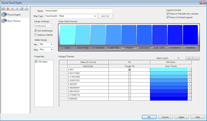

Finally, ensure the 'flood' theme is active by right clicking on the GeoPlan, selecting Properties & Themes... from the context menu, scrolling to the bottom of the list and ensuring the 'flood' check-box is ticked. Press the Edit button to the right and setup a 'Flood Depth' theme using the AutoRange setting and approximately 9 levels. Use a blue fill colour, representing low depths with light blue and deeper water with dark blue. As before, creating exact settings is not important, but a suggested set of parameters is shown below.
