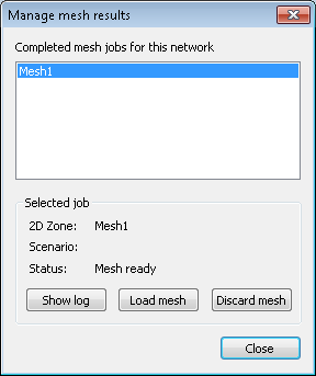

This dialog is used to review the mesh logs of
meshing jobs and to load meshes to the network. It is displayed when Meshing
Load mesh job results is selected from the Model menu.
Select a mesh job for the current network from the list and click:
- Show log to display the Mesh 2D Zones log for the job
- Load mesh to load the mesh to the network
- Discard mesh to remove the mesh job
