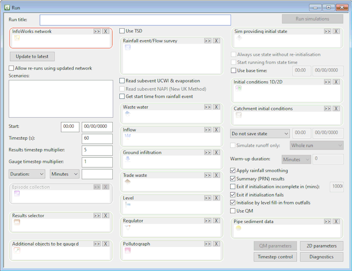

This view is used to schedule one or more hydraulic simulations and, if required, runoff only simulations for an InfoWorks network. A hydraulic simulation will include any 2D simulations and/or water quality simulations providing the information required has been setup before the simulations are run.
The Run view is displayed:
- when a new run is created (right-click a model group in the Explorer window and select New InfoWorks | Run)
- by opening an existing run (right-click a run in the Explorer window and select Open)
An example is shown below:
To run simulations, click:
- Run simulations - if this is a new run
- Run changed simulations - if updating an existing on-premise run
- Re-run simulations - if replacing an existing on-premise run or a failed cloud simulation, or one whose results are unavailable
The total number of hydraulic simulations performed in a run is dependent on which items are specified in the Run view. The maximum number of hydraulic simulations generated will be:
Number of Time varying events (Rainfall events/Flow surveys or TSD objects) x number of Scenarios x the number of episodes included in an Episode collection
The number of runoff only simulations performed depends on which option is chosen to Simulate runoff only, as well as the number of time varying events and scenarios and whether or not an episode collection is included in the run. The option chosen to Simulate runoff only may also affect the number hydraulic simulations that are performed. See the description of Simulate runoff only for further information.
The items included in the Run view are described in the following sections and information about how to create a new run or re-run an existing one is contained in the Runs topic.
Dialog description
Run title and button
| Item | Description |
Run title |
The name of the run. If the entered title already exists, exclamation marks (!) will be appended to the run name until a unique name is created. If a title is not entered, a unique title of the form r0000012 will be generated for you. |
Run simulations Run changed simulations Re-run simulations |
Enabled when current settings in the Run view are valid. Starts the run simulations process. Note: The name of the button is context sensitive, and therefore may change to reflect any modifications made in this window.
