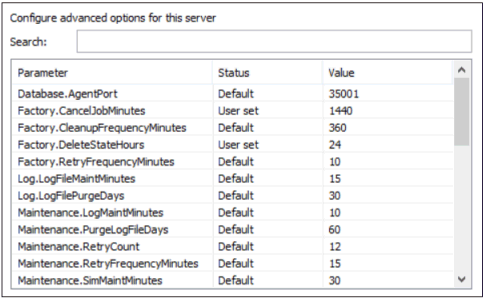

Live Server parameters
The table below lists the available parameters:
| Parameter | Description |
Database.AgentPort |
Database agent handling client connections. Specifies the port that the agent listens to that handles the currently selected database. Default - AgentPort=35001 |
| Factory.CancelJobMinutes |
Defines the number of minutes after a job is submitted to the InfoWorks ICM Agent that it will be cancelled by the Innovyze Live Server if the job is still incomplete. If the value is 0, then submitted jobs will never be cancelled by the Innovyze Live Server. However, they will be cancelled by the InfoWorks ICM Agent in accordance with the Cancel inactive jobs after days setting in the Agent Options dialog in ICMLive Configuration Manager. Default - CancelJobMinutes=1440 |
Factory.CleanupFrequencyMinutes |
Defines how often the state information is cleaned up. Default - CleanupFrequencyMinutes=360 |
Factory.DeleteStateHours |
Number of hours that must elapse before current or previous simulation data can be deleted from persisted state. Default - DeleteStateHours=72 |
Factory.RetryFrequencyMinutes |
For purposes of creating and dispatching simulations Frequency at which database and sim agent connections are to be re-tried when previous connection attempts failed. Default - RetryFrequencyMinutes=10 |
Log.LogFileMaintMinutes |
Text log maintenance is run once per day. This parameter specifies the number of minutes that must elapse after midnight before running the text log maintenance. Default - LogFileMaintMinutes=15 |
| Log.LogFilePurgeDays |
Number of days that must elapse before purging the old text log files. Default - LogFilePurgeDays=30 |
Maintenance.LogMaintMinutes |
Specifies how many minutes past midnight to run sim log maintenance. Sim log maintenance is run once a day. Default - LogMaintMinutes=10 |
Maintenance.PurgeLogFileDays |
Number of days after which old sim maintenance log files are to be purged. Default - PurgeLogFileDays=60 |
Maintenance.RetryCount |
For purposes of running sim maintenance Number of times to retry failed database and sim agent connections before terminating the daily sim maintenance task. Default - RetryCount=12 |
Maintenance.RetryFrequencyMinutes |
For purposes of running sim maintenance Frequency at which database and sim agent connections are to be re-tried when previous connection attempts failed. Default - RetryFrequencyMinutes=15 |
Maintenance.SimMaintMinutes |
Specifies how many minutes past midnight to run sim maintenance. Sim maintenance is run once a day. Default - SimMaintMinutes=30 |
Messenger.BufferDays |
The number of days from the current date that the server will buffer messages that are provided to the Live Operator Client. This controls the number of server messages that a user may view in the Live Operator Client. Default - BufferDays=3 |
Messenger.MaxMessages |
Maximum number of messages that the server will buffer within the period specified in the Messenger.BufferDays parameter. The maximum allowed value is 2000. Default - MaxMessages=500 |
Messenger.PurgePastMidnightMinutes |
Specifies the number of minutes past midnight to purge the previous day messages. Old server messages are purged from memory once per day. Tip: These messages are only purged from the server buffer, not from the system event log.
Default - PurgePastMidnightMinutes=3 |
Monitor.ConnectFrequencyMinutes |
Defines how often a database connection is to be re-tried. Default - ConnectFrequencyMinutes=10 |
Monitor.RetryInitStateMinutes |
Defines how often a state should be re-initialised when a database connection fails when the service is starting. Default - RetryInitStateMinutes=1 |
Monitor.ScanFrequencyMinutes |
Defines how often the database is scanned for changes. Default - ScanFrequencyMinutes=6 |
Run.RunOriginNoDST |
The value, either true or false, indicates whether or not to ignore daylight savings time when calculating run origin dates. RunOriginNoDST=true – The run origin uses the local time, ignoring daylight savings time. RunOriginNoDST=false – The run origin uses the local time only. Default - RunOriginNoDST=true |
Scheduler.NumLateMinutes |
Do not initiate late simulations if the next scheduled simulation starts within the specified time period. Default - NumLateMinutes=15 |
Sentinel.LastFileWriteToleranceSeconds |
Do not initiate an externally triggered run if the last triggered file write has occurred within the tolerance specified since the last file write. Default - Sentinel.LastFileWriteToleranceSeconds=5 |
Sentinel.NumStaleMinutes |
Do not initiate an externally triggered run if the last trigger file write occurred earlier than the current time minus the number of minutes specified. Default - Sentinel.NumStaleMinutes=15 |
SimControl.Hostname |
Sim agent configuration for the server local agent when running on a remote computer Name of the computer that will run simulations on behalf of the server. Default - Hostname= |
SimControl.MaxSimEngineThreads |
Sim engine multi-threading parameter used to control the maximum number of sim engine threads. Any value up to a maximum value of 99 overrides the sim agent setting, but a value of 0 indicates to use the sim agent configured value. Default - MaxSimEngineThreads=0 |
| SimControl.RunAsLogonUser |
Specifies the username credentials used for simulation jobs. RunAsLogonUser=false – Simulations run as the original pseudo-username (InnovyzeLiveServer) that was used as the username at the inception of ICMLive. RunAsLogonUser=true – Simulations run with the username credentials that the Live Server service is configured to logon as. Default - RunAsLogonUser=true |
SimControl.RunOn |
Computer where simulations are run: . - this computer only * - any computer <group> - any computer that is a member of the named group Default - RunOn=* |
SimControl.SimPort |
Sim server configuration for the server local agent when running on a remote computer Port that the sim agent is listening to that is going to run simulations on behalf of the server. Default - SimPort=40001 |
SimControl.UseLocalPipe |
Sim agent configuration for the server local agent when running on the local host The value, either true or false, indicates whether or not to use the sim agent running on the local machine. UseLocalPipe=true - ignores Hostname and SimPort and the server connects to the sim agent running on the localhost using pipes. UseLocalPipe=false - Hostname and SimPort must be configured to a valid remote host / port and the server connects to the sim agent running on the remote host using TCP/IP. Default - UseLocalPipe=true |
| TaskScheduler.NumLateMinutes |
Do not initiate late tasks if the next scheduled task starts within the specified time period. Default - NumLateMinutes=30 |
TransLog.PurgeLogFileDays |
When to purge an old transaction log. Specifies the number of days to elapse before the transaction log is deleted by the Innovyze Live Server. Default - PurgeLogFileDays=60 |
TransLog.StartLogMaintMinutes |
Transaction log maintenance is run once per day. This parameter specifies how many minutes past midnight to initiate transaction log maintenance. Default - StartLogMaintMinutes=20 |
For more detailed information please refer to the Innovyze Live Server Administration Guide available for download here.

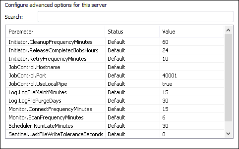

Data Loader parameters
Initiator.CleanupFrequencyMinutes |
Defines how often TSD update jobs are to be released. This also encompasses any other internal clean-up activities. Default - CleanupFrequencyMinutes=60 |
Initiator.ReleaseCompletedJobsHours |
Number of hours that must elapse before a completed TSDB update job is released from the job queue. These jobs are usually failed jobs because successful jobs are released immediately upon completion. Default - ReleaseCompletedJobsHours=24 |
Initiator.RetryFrequencyMinutes |
For purposes of creating and dispatching TSDB updates Frequency at which database and job agent connections are to be re-tried when previous connection attempts failed. Default - RetryFrequencyMinutes=10 |
JobControl.Hostname |
Job agent configuration for the server local agent when running on a remote computer Name of the computer that will perform TSDB updates on behalf of the server. Default - Hostname= |
JobControl.Port |
Job server configuration for the server local agent when running on a remote computer Port that the job agent is listening to that is going to run TSDB updates on behalf of the server. Default - Port=40001 |
JobControl.UseLocalPipe |
Job agent configuration for the server local agent when running on the local host The value, either 0 or 1, indicates whether or not to use the sim agent running on the local machine. UseLocalPipe=1 - ignores Hostname and Port. The server connects to the job agent running on the localhost using pipes. UseLocalPipe=0 - Hostname and Port must be configured to a valid remote host / port. The server connects to the job agent running on the remote host using TCP/IP. Default - UseLocalPipe=1 |
Defines how often database connections are to be re-tried. Default - ConnectFrequencyMinutes=15 |
Defines how often the database is scanned for changes. Default -ScanFrequencyMinutes=6 |
Do not initiate late TSD updates if the last file write has occurred within the tolerance specified since the last file write. Default - LastFileWriteToleranceSeconds=30 |
Do not initiate late TSD updates if the last file write has occurred within the tolerance specified since the last file write. Default - LastFileWriteToleranceSeconds=0 |
For more detailed information please refer to the Innovyze Data Loader Administration Guide available for download here.
