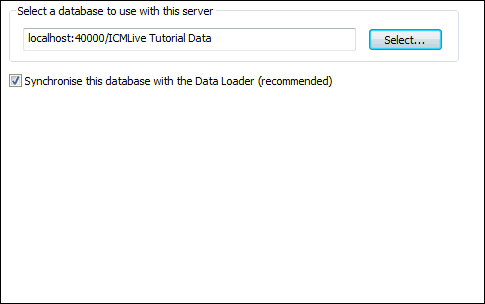

The Database page allows users to configure one or more databases to use with the server.
Live Server
Live Server - Database Page
The table below lists the options available on the page:
Option Description
Select a database to use with this server
Read-only
Displays the path to the currently selected database.
To change the database to use, click Select.
Select
Displays the Open Another Database dialog, allowing the user to select a different database to use with the server.
Synchronise this database with the Data Loader (recommended)
Enabled by default
When enabled, the Data Loader automatically uses the server database (in addition to other databases that may already be configured for use by the Data Loader). When the server database is not synchronised, it is deleted from the list of databases serviced by the Data Loader.

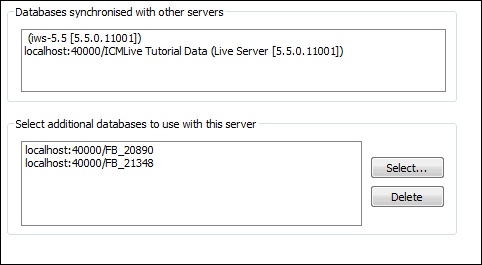

Data Loader
Data Loader - Database Page
Option Description
Databases synchronised with other servers
Read-only
Displays the path to databases that are synchronised with other servers.
Note: The only way to change a synchronised database is from the Database page of the named server.
The Data Loader may also select additional databases that are not synchronised with other servers. These databases are listed in this section.
Select
Displays the Open Another Database dialog, allowing the user to select additional databases to use with the server.
It is possible to select several additional databases and these must be selected in turn.
Delete
Removes the selected database from the list of additional databases.
