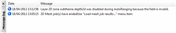

This window contains a list of all popup messages (messages that are displayed for a short time before disappearing) that have been displayed during the current instance of the application.
To turn display of the window on/off, select Message log window from the Window menu
or use the
toolbar button on the
Docking Windows Toolbar
Double-click a message to display the full message in a dialog box.
