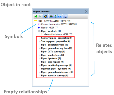

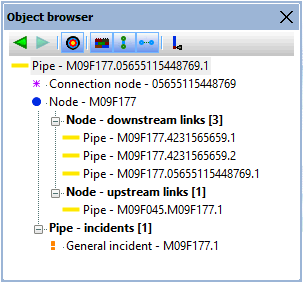

Tree View
The selected object which is identified by type and id is at the root of the tree.
The possible types of related objects are shown below the selected object. Relationship description is displayed in bold, with, in brackets, the number of objects within that relationship.
To expand a relationship group, click on the button.
To expand further, click on the symbol adjacent to the related object. This will display relationships for the related object itself.
To open the object property sheet, double-click the adjacent symbol.
The symbols used are defined by the themes configured in the Layers and Themes page of the GeoPlan Properties Dialog for the current GeoPlan. If that GeoPlan window is closed without the network being closed (e.g. if Network Object Grid Windows are left opened), the object can still be used, but no symbols will be drawn.
The first available GeoPlan window will be used to define symbols if the OBW is accessed via a Network Object Grid Window.
Related objects are grouped by relationship purpose - component, connected, associated and empty. See Object Relationships for more details.
Non-empty (i.e. component, connectedand associated) relationships are shown by default.
To view empty relationships, click the Show empty relationships button (). To hide these relationships, click this button again (it is a toggle).
Additionally, displayed relationships can be restricted to a certain purpose (component, connected or associated, or any combination) of relationships by using the relevant toolbar button (Show component relationships / Show connected object relationships / Show associated object relationships, respectively). These buttons are all toggles therefore clicking on them again will hide Containing, connected and associatedrelationships respectively.
