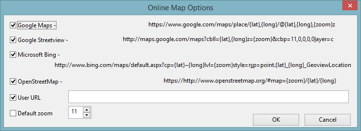

The Online Map Options dialog is used to select the online maps that can be used to view the location of the GeoPlan. It is also possible to specify a user-defined URL.
The dialog is displayed when the Online Map Options button is clicked in the GeoPlan Page of the Options Dialog.
| Option | Description |
Google Maps |
Web mapping service application provided by Google™. |
Google Street View |
Technology featured in Google™Maps and Google™Earth that provides panoramic views from positions along many streets in the world. |
Microsoft Bing |
Web mapping service provided as a part of Microsoft™'s Bing suite of search engines. |
OpenStreetMap |
Collaborative project set up to create a free editable map of the world. |
User URL |
User-defined URL. Tip: Please note that {long} {lat} and {zoom} must be specified in that order. See the example urls given for the built in online maps in the dialog itself.
Default zoom |
Zoom in arbitrary units (0 to 20). To specify a zoom level for all web maps, check the adjacent check box and select a value. If this option is not enabled (i.e. unticked checkbox) the online map zoom level will match the GeoPlan current zoom level. |
OK |
Commit the changes and close the dialog. |
Cancel |
Abort the online map configuration. |
Select the desired web mapping services by ticking the check box adjacent to them.
These will appear as context menu options when the GeoPlan Window is right-clicked. See Viewing GeoPlan Locations and Objects on an Online Map for more information.
