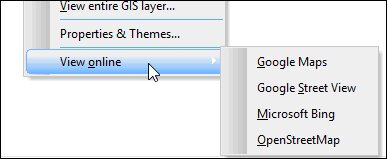

- Click on the location/ object of interest on the GeoPlan, and select View online from the context menu, then choose the desired map service.

Online map availability on the GeoPlan context menu is configured in the Online Map Options dialog. Supported types include:

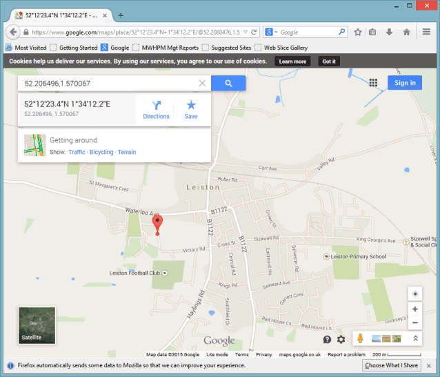

- Google™Maps
- Google™ Street View

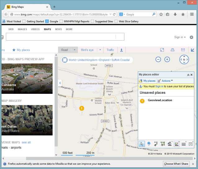

- Microsoft™ Bing
- OpenStreetMap
- User-defined URL
- The selected web mapping software is launched using the default browser and opens the map with the location / object corresponding to the GPS coordinates that have been clicked on the GeoPlan highlighted on the map. By default, the map will be centred on these coordinates:
In order to use web mapping software it is essential to manually set a coordinate system for databases with no map control specified.
GoogleMaps
Microsoft Bing
