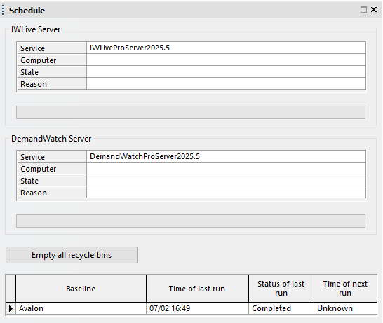

The Schedule window displays details of the current server(s) and a grid of the most recent projection run for each baseline (Headlines page) or the selected baseline (Zones page). The window is displayed on the left side of the Headlines page, and in the Zones page.
To display the window, click the Schedule tab on the left of the Headlines / Zones page, or select Window | Schedule.

All fields in the window are read only:
Field Description
IWLive Server
IWLive Server details:
  • Service - name of the service
  • Computer - name of the computer that the service is running on
  • State - state of the service:
    • Running
    • Stopped
    • Paused
    • Start Pending
    • Stop Pending
    • Pause Pending
    • Continue Pending
    • Error - an asterisk (*) indicates that further error information is available. Hove the mouse over the cell to view additional information.
Empty all recycle bins
Click the Empty all recycle bins button to delete all runs with Status set to Marked for deletion for all the baselines in the database. The status of a run can be set in the Run Admin window.
Tip: It is possible to delete all the runs marked for deletion for the current baseline only by using the Empty bin button of the Run Admin Window.
Please note that in addition to this, the server will perform automated emptying of recycle bins as specified by the Configure Clean Up dialog, which is accessible from the Configuration menu.
Baseline grid
List of baselines and projection run details:
  • Baseline - name of baseline
  • Tip:
    In the case of the Zones page, the Schedule window shows only the most recent projection run for the currently selected baseline. This is why only that baseline name will appear in the Baseline column.
  • Time of last run - time of the most recent projection run
  • Status of last run - status of last run.
    • If the run has been verified, this field will display the verification status, for example Well verified.
    • If the run has not been verified, the field will show the simulation status, for example Completed.
  • Time of next run - time that next projection run is scheduled to be carried out
