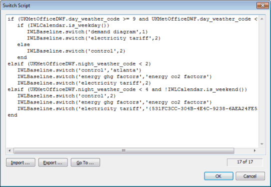

The Switch Script dialog page is used to view and edit ruby scripts that define when switch objects (defined in the Baseline - Switch Options) are to be used based on weather feed data.
The dialog is displayed via the Edit Script button on the Baseline - Switch Options page.
The Import button allows data to be imported as a ruby script
The Export button allows the current script to be saved to a text file
The Go To button is used to move the cursor to a specified line. The box on the bottom right of the page displays the current line number followed by the total number of lines in the script.
Note that only ANSI encoded scripts are supported.
For details on the script language, see the Switch Configuration Script Language topic.
