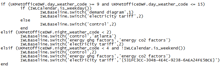

Ruby scripts are written to define when switch objects are to be used based on weather feed data and date.
An example of a script is shown below:

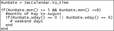

to_time
Returns a Ruby.Time object for the current forecast date. For more information on the use of Ruby time type, please follow this link.
Note: The value given by IWLCalendar.to_time is initialised to midnight on the day of the run, so only date values can be examined in a meaningful way (i.e. hour and minute are always 0). This means that the value of IWLCalendar.to_time is in fact the date at the start of the run.
For example, to switch between day of the week use wday() (Sunday = 0; Saturday = 6) or to switch between month use mon() (January = 1; December = 12).
