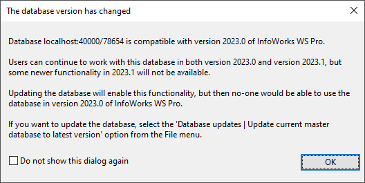

Warning message for a database version change
When you open a newly installed version of InfoWorks WS Pro, a new dialog is displayed.
It informs you that the database version has changed, and the implications for updating a master database.
It also contains a check box that lets you choose whether or not the dialog is displayed again. If unchecked (default), the dialog is displayed the next time you try to open an older master database.
The dialog replaces the Update to Later Database dialog that was previously displayed when you installed a new version of InfoWorks WS Pro.

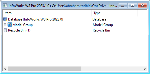

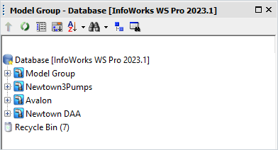

Database version number display
To make it easier to know which version of a master database you are using, the version number is now displayed in the title and tree view in the Model Group window and Explorer Window.
The version number for a non-current transportable database is now displayed in the window title and the tree view, while the version number for a read-only transportable database is displayed in the tree view.
