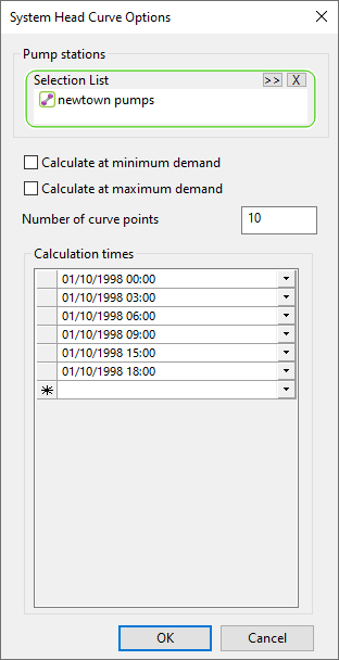

System head curve options
System head curve options dialog
This dialog view allows you control the output of the System head curve run.
Show image
Item Description
Pump stations
Selection List (drop target)
Use drag and drop or the Browse button to add a selection list of pump stations to be analyzed.
Browse Browse Click to open a dialog from which you can choose a run.
Clear Clear Click to clear the entry in the Run box.
Calculate at minimum demand
Option to calculate a system head curve when demand is minimum.
Calculate at maximum demand
Option to calculate a system head curve when demand is maximum.
Number of curve points
Gives the level of detail (test points) in the system head curve.
Calculate times
List of times at which system head curves will be calculated.
