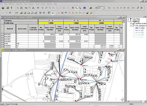

Figure 2. Demand allocation – assigning demand to nodes.
The main purpose for providing the direct link between InfoWorks WS and ESRI products is to facilitate model building and automatically allocate demand using a combination of GI data (shapefiles, ArcInfo data), Office data files (e.g. Access, Excel), text files (e.g. comma-separated variable). The tools in InfoWorks WS have been developed using MapObjects technology to enable the:
- Automatic derivation of elevations at all nodes, spatial data (e.g. bursts, complaints) and customer points using the UK Ordnance Survey Landform Panorama data set.
- Automatic allocation of demand at any node and/or pipe using geo-referenced seed point information such as address point (see Figure 2)
- Incorporation of any geo-referenced information to support the modeling process such as customer complaints and pipe bursts. These can then be allocated to the nearest main and pipes graded by structure as well as hydraulic condition.
Figure 2 illustrates the incorporation of address point data to allocate demand at nodes. The address point data was imported into InfoWorks in shapefile format, having been prepared using ArcView. A base demand is applied for unmetered customers in appropriate units (eg. litres per property per day) or for metered consumption demand can be extracted from the billing data.
