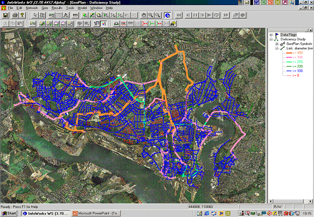

Sample screen 1- A system overview highlighting key distribution mains
By simulating demand growth/decline and changes in non-revenue water to reflect expected future system operation, companies can ensure that their capital investment program is targeted to meet these challenges.

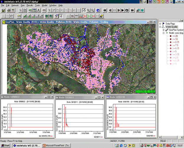

Using advanced modelling tools such as Wallingford’s InfoWorks WS software, companies can track the fate of any decaying or non-decaying substances as they move through the distribution system. This understanding enables the modeller to assess the action that must be taken, identify the required response time and address the most critical areas first.
Sample screen 2 - Tracking the fate of a pollutant through the system
The model can then be used to simulate mains flushing to facilitate the effective removal of the pollutant from the system, minimising the disruption to normal supplies.

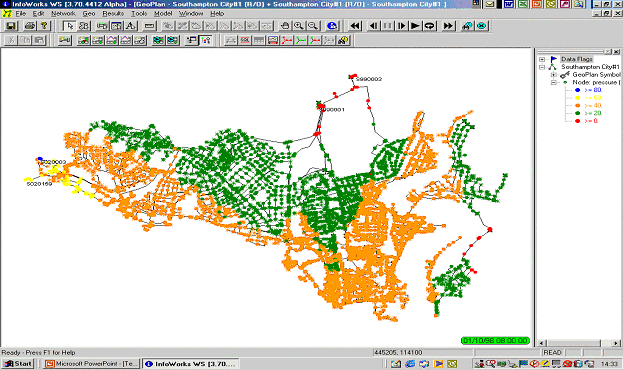

A calibrated model can be used to assess the current system operating pressures and design pressure management schemes.
Sample screen 4 - Assessing the potential for a pressure management scheme
