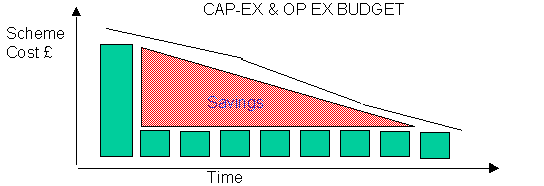

The cost of developing a well-calibrated fully dynamic model is often only a fraction of the cost of any single scheme it is used to design. If the model is used on a regular basis the initial cost of development soon becomes insignificant. We have to consider the potential overspend if errors are made in the design as a result of not fully analysing the problem using a Network Model. The cost of re-design, asset replacement, customer compensation and adverse publicity are all factors that should be taken into account.
Models can also be used to optimise the use of pumping plant, and can achieve considerable saving in operational costs. These savings in power and sometimes in reduced maintenance costs alone often far outweighs the investment required in the model construction.

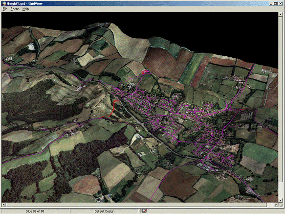

3D imaging in GIS using Triangular Irregular Networks (TIN)

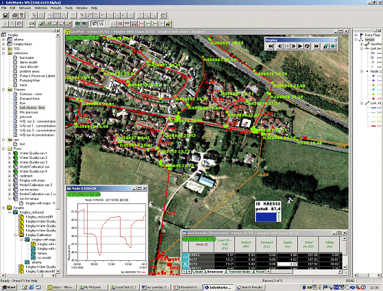

Linking Network Models to Telemetry systems provides an ongoing check that our theoretical model of the system is performing satisfactorily. This gives us confidence to use the model to make operational decisions and plan for future system development. The Model can also be used for contingency planning, reflecting or indeed guiding changes made in the real system to react to emergency situations.
Information from SCADA systems, Telemetry and temporary or permanent logging can be used essentially in three ways:
- To enable the latest system information to be available to aid model calibration
- Controlling model operation based on data directly obtained from the real system
- Controlling the real system based on the model results – truly integrating Network Modelling and SCADA systems in an operational environment.

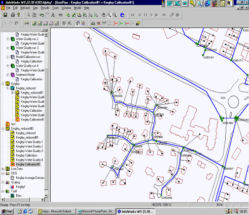

- Demand Allocation
- Setting elevation of nodes and customer points
- Setting internal diameter and initial roughness values from look-up tables
- Network connectivity tracing and data cleansing
The latest software has therefore developed considerably beyond just simulation. The automation of previously time-consuming tasks has led to significant savings in the model building process. Figures in the order of a 40% saving in the total cost of model building and calibration using the most modern software compared to traditional model building techniques are now being achieved. This together with the improved model accuracy and complexity has enabled Network Modelling to answer the criticism that models are expensive and time consuming to construct, and of little practical use in planning and operational decision making due to over-simplification because of limited software capability.
Automated Demand Allocation showing address points assigned to pipes
