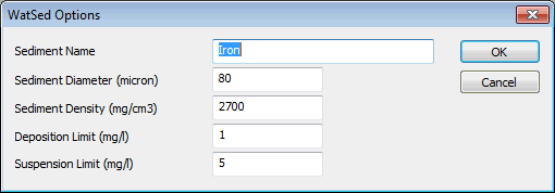

WatSed Options dialog
Use the WatSed Options dialog to set the additional options used for a WatSed Simulation.
The dialog is displayed when you select WatSed as the Run Type, and then click the Options button on the Schedule Hydraulic Run View.
The dialog will always display the default options for Iron deposits in the pipe. You can change any of the parameters you want. The required parameters are:
| Parameter | Description |
Sediment Name |
Descriptive name for the sediment - maximum 30 characters |
Sediment Diameter (microns) |
The diameter of particles representative of those likely to cause noticeable water quality deterioration Default = 80. Minimum = 45. Maximum = 200. |
Sediment Density (mg / cm3) |
The density of the particles Default = 2700. Minimum = 2000. Maximum = 4000. |
Deposition Limit (mg / l) |
If the calculated carrying capacity of the pipe is less than the deposition limit then sediment is being deposited in the pipe Default = 1. Minimum = 0. Maximum = 20. Subject to the restriction that Suspension Limit > Deposition Limit. |
Suspension Limit (mg / l) |
If the calculated carrying capacity of the pipe is greater than the suspension limit then sediment is eroded from the pipe bed and remains in suspension Default = 5. Minimum = 0. Maximum = 20. Subject to the restriction that Suspension Limit > Deposition Limit. |
