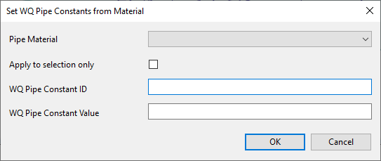

The Set WQ Pipe Constants from Material dialog is used to set the WQ pipe constant ID and value for a given set of pipe materials.
This dialog can be accessed from Model | Set WQ Pipe Constants.
This is an easier way of setting the WQ pipe constants, compared to using the Water Quality (MSQ) page.
You have the option to apply the new WQ pipe constants to a selection only, or to all pipes with a particular material.
The application will go through the network and find all the selected pipe materials, and change them based on the assigned ID and value.
| Item | Description |
| Pipe Material |
Drop-down list of all the pipe materials from the pipe data fields. |
| Apply to a selection only |
When not checked, the WQ pipe constants will be applied to all pipes for the selected pipe material. When checked, it will apply the WQ pipe constants to a selection only. By default, this is not selected. |
| WQ Pipe Constant ID |
The new WQ pipe constant ID that you prefer |
| WQ Pipe Constant Value |
The new WQ pipe constant value that you prefer. |
