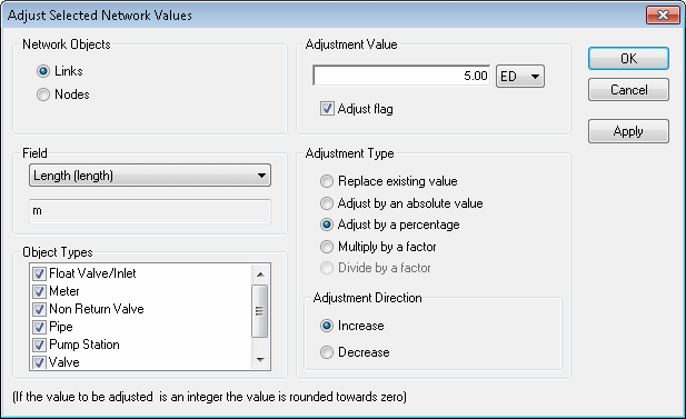

This dialog allows you to replace or adjust the values of one or more fields for a set of selected network objects.
Before opening the dialog, you need to select all the network objects you want to change. Make sure no other objects are selected.
The dialog is displayed when you choose Selection
Selection operations
Adjust selected values.
For more information on the various methods of adjusting parameters for a group of network objects, see Editing Object Parameters.
| Item | Description | ||||||||||||
Network Objects |
Choose whether you want to adjust nodes or links. |
Field |
Select the field you want to adjust. The list uses the field name from the database. The lower box displays the name you usually see on the grids and property sheets. |
Object Types |
Once you have chosen a field, the types of node or link for which this field is relevant are listed. You can uncheck types you do not want to change. |
Adjustment Value |
Enter the new value for the field here. For numeric fields you can replace the current value or adjust it by a factor. See below for more. You can change the flag for the field at the same time. Check the Adjust flag box, then select a flag from the dropdown list. Note: When adjusting integer values by a percentage or using a multiplier, non-integer outcomes are always rounded towards zero. For example, a value of 3.6 is rounded down to 3 while a value of -3.6 is rounded up to -3.
| Adjustment Type |
