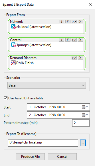

This dialog is displayed when exporting a network to an EPANET v2 file.
| Item | Description | ||||||
| Export From |
| Scenario | If the network has more than one scenario, you can choose which one to include in the export from the drop-down list. | ||||||
| Use Asset ID if available |
Allows you to export Asset IDs instead of object IDs. The IDs are shortened to 31 characters if necessary. The original object ID is shown as a comment at the end of each line in the exported file, if it has been changed. |
| Start / End |
The simulation period start and end times as required. The values are populated from Simulation Control. You can modify the start and end times by selecting from the drop-down menu. |
| Pattern timestep (min) |
The time (minutes) interval used with all time patterns. |
| Export To (filename) |
The text box contains a suggested name for the export file. You can change this name if you want to. The ellipsis button opens a standard Windows Save As dialog for selecting the location to which the file is to be exported. |
| Produce File |
Carries out the export. |
