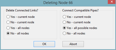

| Delete Connected Links?
Yes - current node: deletes links connected to node displayed in title bar and then displays dialog again for the next selected node
No - current node: does not delete links connected to node displayed in title bar when node is deleted and then displays dialog again for the next selected node
Yes - all nodes: deletes links connected to all selected nodes in one action
No - all nodes: does not delete any of the links connected to selected nodes when the nodes are deleted
| Connect Compatible Pipes?
Yes - current node: joins links connected to node displayed in title bar if the links are compatible and then displays dialog again for the next selected node
No - current node: does not join links connected to node displayed in title bar when node is deleted and then displays dialog again for the next selected node
Yes - all possible nodes: joins compatible links connected to all selected nodes in one action
No - all nodes: does not join any of the links connected to selected nodes when the nodes are deleted
When connecting compatible pipes, if there are differences in pipe values, the
Resolving Connected Pipe Attributes dialog will be displayed.
| OK button
Carries out delete action
| Abort button
Dismisses dialog. No further deletion will be carried out.
