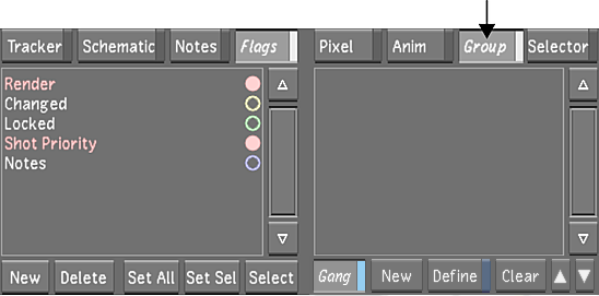

To create a shot group:
Click Group.
Note:You can access the Group button from any menu except the Animation menu.Click New.
A new group called group1 is created and the Define button is enabled. This allows you to add shots to the shot group and select the parameters that are applied to the grouping.

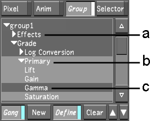

Select the channels in the list for the parameters that you want to apply to the group:
- To select all channels in a directory, select the directory.
- To select a subset of the channels in a directory, click the arrow to the left of the directory to expand the directory, and then select the channels.
- To deselect a directory or a channel, click it.
(a) Deselected directory (b) Selected expanded directory (c) Selected channel
