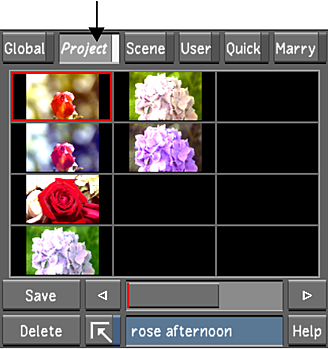

Select the Grade bin you want to use (for example, the Grade bin for the current project).

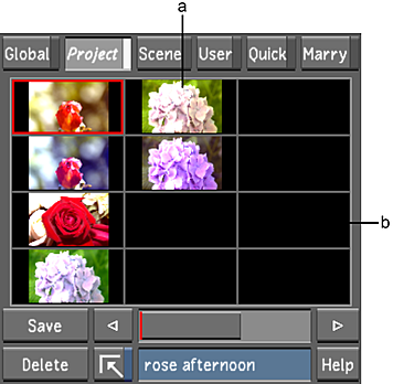

- To create a grade, select an unused storage container.
- To update a grade with modified settings, select the storage container of the grade you want to update.
(a) Used storage container (b) Unused storage container
Note:When you add a grade to a container in the last column of the Grade bin, three new columns are automatically added to the right. You can add an unlimited number of grades.Click Save.

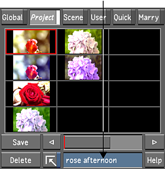

Tip:You can use the thumbnail as a reference image while you work on another shot. See Viewing Reference Images.(Optional) Enter a name or comment in the Note field and press Enter.
