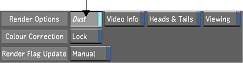

You can render shots with or without dust metadata. This is a workflow decision. You can render dust metadata either from the Render Local menu or from the Image Dust menu. See Rendering the Result.
To render shots with dust metadata, you must first use the dust removal tools to remove dust artefacts. See Removing Dust.
To render shots with or without dust metadata:
  1. In the Render Local menu, do one of the following:
    • To render shots without dust metadata, disable Dust.
    • To render shots with dust metadata, enable Dust.
