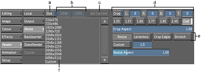

(a) Size button (b) Custom Width and Height fields (c) Set Current button (d) Crop options (e) Resize options(f) Video and film format list
To resize to a new format, such as a video format, enable Size, and then select a format from the list. If you select Custom, you can enter a width and height in the Width and Height fields, or click Set Current to set the format to the current frame size.
If the selected format is larger than the original image size, by default a black border appears around the image, showing the final output size. If the selected format is smaller than the original image size, the image is cropped, showing the final output size.
Note:You can check the resolution of the original scans in the Library, accessible from the Editing Browse menu. Source resolution is important for quality resizing. For example, you obtain a better quality HD output with 2K full scan sources than with 1K half scan sources.Select a Resize option to specify how the image will fit into the specified format.

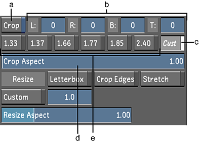

Select: To: Letterbox Fit the entire image into the specified output format. Vertical or horizontal black borders accommodate any difference in the aspect ratio of the original image and final output format. Crop Edges Fill the new format size with the image, cropping the edges of the original image as needed to accommodate differences in the aspect ratio of the original image and final output format. Stretch Stretch the original image to fit the specified output format. If the aspect ratio of the original image and final output format is different, the image is distorted. Set the crop size. Enable Crop and then do one of the following:
- Enter custom crop values in the Left, Right, Bottom, and Top fields.
- Enable one of the standard Crop Preset buttons.
- Enable Cust and then use the Crop Aspect slider to set the aspect ratio of the crop.
(a) Crop button (b) Left, Right, Bottom, and Top fields (c) Cust (Custom) button (d) Crop Aspect slider (e) Crop Preset buttons
Note:Cropping in Lustre affects both output resolution and how the source file is read. For example, if you crop a 2K (2048x1556) scan to 1:85, the render size becomes 2048x1107. Lustre also reads the scan more quickly since there are fewer lines of pixels to go through.To proportionally scale the image, enable Cust and then enter a scaling value in the Cust field.
