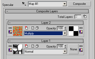

CompositeTextureMap : TextureMap
CompositeTextureMap - superclass: textureMap; super-superclass:material - classID: #(640, 0)
The CompositeTextureMap has been reimplemented in 3ds Max 2009 but provides backwards compatibility with files containing the old version of the map.

Properties:
<CompositeTexturemap>.blendMode ArrayParameter default: #(0) -- int array; Map_Blend_Mode
Get/set the blend modes associated with all layers as an array of integers.
Available in 3ds Max 2009 and higher.
Possible values are:

Composite Texturemap interfaces:
Interface: layers
Methods:
<void>add()
Adds a new layer to the Composite Map. Equivalent to pressing the "Add a New Layer" icon in the UI.
<void>delete <integer>index
Deletes the indexed layer of the Composite Map. Equivalent to pressing the "Delete This Layer" icon in the UI.
<void>duplicate <integer>index
Duplicates the indexed layer of the Composite Map, creating an identical new layer. Equivalent to pressing the "Duplicate This Layer" icon in the UI.
