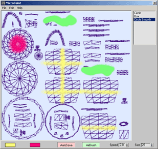

In this step of the Bitmap Painting tool development, we will add the option to generate a graphical representation of the UV coordinates of an object inside the painting tool and assign automatically as diffuse map to the scene object.
NATURAL LANGUAGE
We will add a local variable to store the mesh object to work with.
We will add a new filter function to select only mesh objects.
We will add a new pickbutton to the UI to select an object to work with which will use the filter function.
We will add an option to the Edit menu to acquire the texture coordinates.

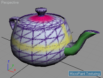

We will add a new function to read the UV coordinates from a selected mesh and draw strokes in the painting based on the vertex positions in texture space.
We will define a default temp. file name for the painting and will optionally save it after each stroke.
We will assign the temp. disk copy of the bitmap to the diffuse channel of the picked object.
We will add a new checkbox to the User Interface to enable and disable autosaving. When enabled, the bitmap will update in realtime as we paint in our tool.

fn unwrapTexture =
if theObj != undefined then
theMesh = snapshotAsMesh theObj
if meshop.getMapSupport theMesh theChannel do
faceCount = meshop.getNumMapFaces theMesh theChannel
for f = 1 to faceCount do
theFace = meshop.getMapFace theMesh theChannel f
vert1= meshop.getMapVert theMesh theChannel theFace.x
vert2= meshop.getMapVert theMesh theChannel theFace.y
vert3= meshop.getMapVert theMesh theChannel theFace.z
drawStroke [vert1.x * bitmapx_1, bitmapy_1 - vert1.y * bitmapy_1] [vert2.x * bitmapx_1, bitmapy_1 - vert2.y * bitmapy_1] drawIt:false
drawStroke [vert1.x * bitmapx_1, bitmapy_1 - vert1.y * bitmapy_1] [vert3.x * bitmapx_1, bitmapy_1 - vert3.y * bitmapy_1] drawIt:false
drawStroke [vert3.x * bitmapx_1, bitmapy_1 - vert3.y * bitmapy_1] [vert2.x * bitmapx, bitmapy_1 - vert2.y * bitmapy_1] drawIt:false
theCanvas.bitmap = theCanvasBitmap
save theCanvasBitmap
if theObj.material == undefined do theObj.material = Standard()
if theObj.material.diffusemap == undefined do
theObj.material.diffusemap = bitmapTexture filename:temp_bitmap_filename
showTextureMap theObj.material true
autoSave.checked = true
--NEW UNWRAP TEXTURE FUNCTION ENDS HERE

To calculate the position of the UV coordinates inside the bitmap, we have to count the pixels as the size of the bitmap minus one (for example, 0 to 511 and not 1 to 512). To make out life easier, we define two variables to store these corrected values.
local temp_bitmap_filename = (getDir #preview +"/microPaint_temp.tga")
local theCanvasBitmap = bitmap bitmapX bitmapY color:white filename:temp_bitmap_filename
To be able to save the current painting to a temporary file on disk, we have to define a file name and assign it to the bitmap. The file name is stored in a local variable that will be used in other parts of the script to access it. TGA appears to be faster to save than BMP, but you can save to any format you want.
local theBackgroundBitmap = bitmap bitmapX bitmapY color:white
local currentPos = lastPos = [0,0] localtheChannel = 1
This is the map channel to read from. You can add a User Interface spinner to control its value. For now, we will work with channel 1 only.
local theObj = undefined
This variable will store the mesh object to access the UV coordinates from.

We add a new menu item that will be used to acquire texture coordinates from a scene object.
on commit_menu picked do copy theCanvasBitmap theBackgroundBitmap on uv_menu picked do MicroPaint_CanvasRollout.unwrapTexture()
If the user picked the menu item, we call a new function that will be defined inside the rollout (see below).

In this example, Unwrap UVW modifier is applied to a teapot and the Flatten function is used to create the new texture coordinates.
Then, the object is selected in MicroPaint and the texture coordinates are drawn using the Circular Smooth brush with size 5, Airbrush turned on, and Airbrush Speed set to 1.0.
This is the teapot as seen in the viewport:
Now, you can start painting on top of the UV coordinates using all available brushes - as long as the AutoSave button is checked, all your strokes must update in the viewports:
