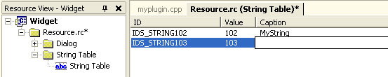

  1. open the resource editor,
  2. open the context menu from the resource view (e.g. by right-clicking with the mouse)
  3. select "Add Resource"
  4. select the "String Table" resource type.
  5. The string table resource editor will look like the following:
