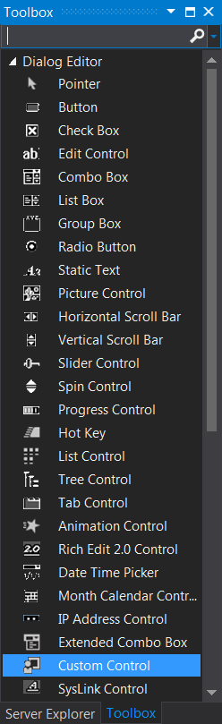

The custom controls are positioned in a rollup page like any other control. Each one is created using the Custom Control button. The Custom Control button is the one shown highlighted below.

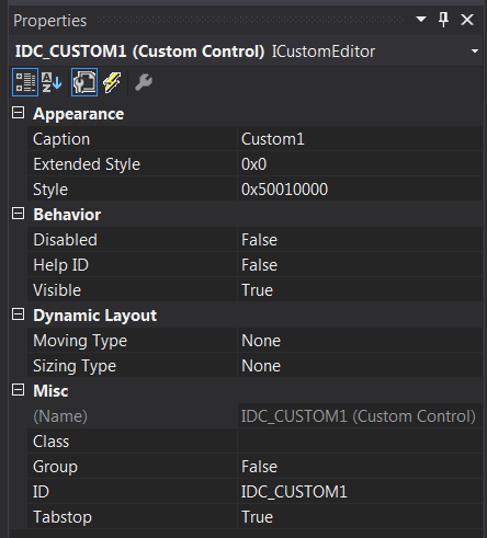

The control is identified as being custom by filling in the Class field of the Custom Control Properties dialog box with an appropriate string indicating the type of control. To bring up this dialog, double click on the control in the dialog editor window.

The other fields in the user control properties dialog are these:
ID - This is the resource's identifier. The resource ID is usually a symbol supplied by Visual C++ and defined in the .H file that Visual C++ creates as part of your project. This is where you define the symbolic name for the resource.
Caption - This is the text that appears as part of the control to label it. This field is used for Custom Buttons and Status controls.
Visible - This determines whether or not the control is visible when the application is first run.
Disabled - This determines if the resource is displayed as disabled when the dialog box is created.
Group - This specifies the first control of a group of controls in which the user can move from one control to the next by using the arrow keys. All controls in the tab order after the first control with the Group property set to False belong to the same group. The next control in the tab order with Group set to True ends the first group of controls and starts the next group.
Tabstop - This specifies that the user can move to this control with the TAB key. This is only appropriate for the edit and button controls.
Class - The name of the control's Windows class. This class must be registered before the dialog box containing the control is created. See the class list above.
Help ID - Assigns a help ID to the control. The help ID is based on the resource ID. Type: Bool. Default: False.
Style - A 32-bit hexadecimal value specifying the control's style, primarily used to edit the lower 16 bits that make up a user control's sub-style.
ExStyle - A 32-bit hexadecimal value specifying the control's extended style.
