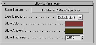

3ds Max uses the annotations to create the UI elements. The effect file created by combining the above two snippets gives the following UI:
