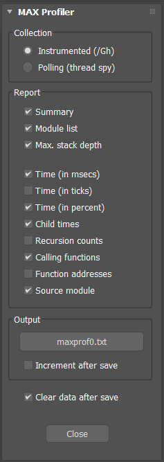

The profiler is a utility plug-in ( \maxsdk\plugin\x64\release\maxprofiler.dlu ) with an interface in both the command panel and a small floating dialog. The command panel interface is used to indicate which type of profiling is done, which information is written to the output file, and what file name its written to. The floating dialog is used for starting, stopping, saving and clearing the profile recording.
To run the profiler, copy it and the associated .dlu.mui file to a location in 3ds Max's plugin search path, for example [maxdir]\Plugins. Select 3ds Max Profiler from the list of utility plug-ins. A smaller floating dialog appears as well as the command panel interface. Via radio buttons in the Collection area choose if you want to perform Instrumented or Polling profiling.
To collect profiling information you select the options you want to record using the check boxes in the Report area of the command panel rollup. Next choose the desired output file name, from the Output rollup. By default the output file is written to maxprof0.txt in the same directory as the currently loaded 3ds Max file.
Once these choice have been made, click on the Record button in the floating dialog. This puts the profiler in record mode -- ready for the collection of profiling information.
Next, simply use the plug-in you wish to profile. For instance, if your plug-in is a modifier, apply it to an object and adjust its settings. As you work with the plug-in, or 3ds Max calls its methods, the profiling information is collected. The floating dialog stays active even if you leave the utility branch of the command panel so you're free to use all of 3ds Max to fully test your plug-in. Note that the profiler is persistent even through a 3ds Max File / Reset operation. This allows developers to track what calls are made during a Reset as well. If you want to reset the profiling information, press the Clear button on the floating dialog.
This section list each of the controls in the command panel user interface:
Report section:
The check boxes in this section determine which portions of the output file are written. Below is a description of each of the options in this dialog. The sample output file shown later in this topic shows an example what is written for each of these.
  • Summary: This generates some basic information about the speed of the machine 3ds Max is running on, the amount of time spent profiling, and the number of functions that were profiled.
  • Module list: This generates a list of all the modules that are loaded into process memory.
  • M ax stack depth : This reports the maximum depth of function calls the profiler reached.
The following options are reported for every function that is called. These items appear as columns of data in a table where each row represents one function call.
  • Time (in msecs): This is the amount of time spent in the function in milliseconds. This is labeled SelfTime in the output table.
  • Time (in ticks): This is amount of time spent in the function in ticks. This is labeled SelfTicks in the output table.
  • Time (in percent): This is the time in a function as a percent of the overall time spent in all the functions that were profiled. This is labeled SelfPercent in the output table.
  • Child times: If this is checked, three new columns are added to the output table. These are labeled HierTicks, HierTime and HierPercent. These are similar to those above, but include not only the function itself, but also any functions it calls. This one is useful because you can sort the table by child times (in a spreadsheet such as Excel) and it will display the most time intensive functions first.
  • Recursion counts: This option is useful if you have recursive functions. It shows how many time the function calls back on itself. This is labeled Recursions in the output table.
  • Calling functions: This generates a multiline entry. For each function profiled, a list of all the functions, or places within a function, that called it are shown. This also lists how many times each of the functions called it.
  • Function addresses: This generates the address in memory for the function. This is labelled Address in the output.
  • Source module: This generates the name of the module (the name of the DLL that the profiled function lives in). If you are running under NT5 and have IMAGEHLP.DLL you'll get the source file name and line number. This is labelled Module in the output. The number of calls (labeled Count in the output table) is always reported. This is the number of times the function was entered.
Output section:
Output file selector button: By default, the output is written to the path where the 3ds Max file was loaded. Clicking on this button brings up the file selector dialog for choosing a new output file.
Increment after save: This check box is enabled only when the filename has a number or numbers at the end. If checked, the file name shown on the button is incremented each time the profiling information is saved. If unchecked, the file is overwritten on a save.
Clear data after save: This check box resets the profiler after each time the profiling information is saved. If this is off, profiling information continues to accumulate after a save.
Close: This closes the 3ds Max Profiler plug-in in the user interface.
