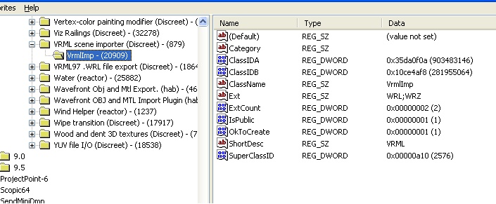

Example
The following is an example from the VRML plug-in for 3ds Max:
| Name | Type | Data |
| DLLFile | REG_SZ | vrmlimp.dli |
| LibDescription | REG_SZ | VRML Scene Importer (Discreet) |
| LibVersion | REG_DWORD | 0x1f401100 (524292352) |
| TimeStampHigh | REG_DWORD | 0x01c6203e (29761598) |
| TimeStampLow | REG_DWORD | 0x63bc8c00 (1673300992) |
Notes: The DLLFile value gives the name of the DLL file that this key describes; case is disregarded. The name must be unique, and must not match two different files, even if they are in different directories.
Class Key Values
| Category | REG_SZ | |
| ClassIDA | REG_DWORD | 0x35da0f0a (903483146) |
| ClassIDB | REG_DWORD | 0x10ce4af8 (281955064) |
| ClassName | REG_SZ | VrmlImp |
| Ext | REG_SZ | WRL;WRZ |
| ExtCount | REG_DWORD | 0x00000002 (2) |
| IsPublic | REG_DWORD | 0x00000001 (1) |
| OKToCreate | REG_DWORD | 0x00000001 (1) |
| ShortDesc | REG_SZ | VRML |
| SuperClassID | REG_DWORD | 0x00000a10 (2576) |
Notes: The IsPublic and OKToCreate values should be 0 (no) or 1 (yes). The Ext value consists of upper-case file extensions (without the leading dot); if there are more than one, they are separated by semicolons, with no spaces before or after. The number of extensions given in the Ext value must agree with the ExtCount value. The InternalName value should not be defined if it returns NULL.
