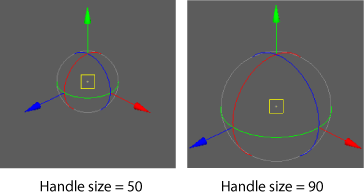

- Handle size
Specifies the size of the handle. The range is from 4 to 100.

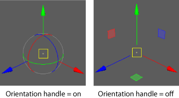

Pivot Manipulator
- Orientation handle
- Controls the visibility of the orientation handles. The orientation handles are turned on by default.
- Orientation handle size
- Sets the size of the orientation handles. The default size is 50.
