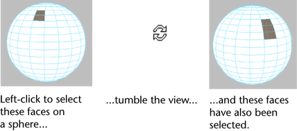

Note: If you want elements to light up when you select them, see Selection Highlighting in the Show panel menu. (The Panel menus appear above the scene view.) - Disable pick chooser for components
Choose to have pop-up selection on for objects, and off for components. This is useful to prevent the following situation: you have the Pick Chooser menu turned on and you’re in component mode, you can accidentally select faces or vertices on the opposite side of an object when you don’t want to (this is most obvious when Select faces with whole face is on).
This behavior is a consequence of the Pick Chooser menu. To make sure that only the clicked-on components are selected, turn on Disable Pick Chooser for Components.

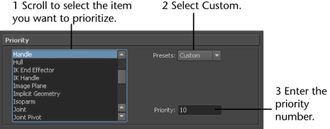

Priority
