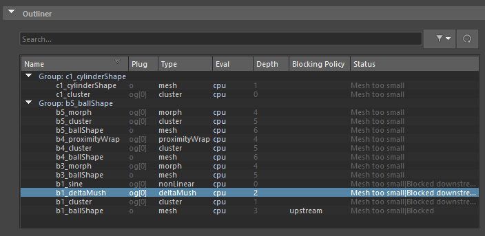

- Works with the Evaluation Manager to accelerate deformations in either
Serial or
Parallel Evaluation mode. If your scene has standard
Maya Creative deformers and the mesh geometry is dense, this can improve performance. Results vary based on the deformers and density of meshes in your scenes.
Note: GPU override works only with Viewport 2.0 and does not work with Quadro 4000 graphics cards on OSX.
- You can find a technical explanation of GPU Override at Using Parallel Maya.

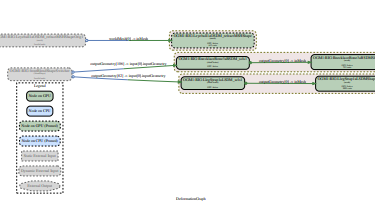

- Graphical Output
- Tools in this section will provide an output in either PDF or
DOT format for visualization of the evaluation or scheduling graphs. The visualization is similar to what you see in the node editor for the dependency graph.
Format Select the type of output you wish to produce. If PDF is set, then the graph is sent to a .pdf file. If DOT is set, then the graph is sent to a .dot file. In both cases, the tool attempts to open the file in your default application for the generated file so you can see it immediately. For example Adobe Acrobat for a .pdf file and graphviz for a .dot file. The Transitive Reduction checkbox is an option that tries to reduce the number of unnecessary connections in the graph being displayed. The resulting output is cleaner though it can take significantly longer to generate.
Output file This field shows where the file is created. By default, it is stored in your MAYA_LOCATION directory. Enter a new file name or browse to a new directory to change the location. The extension on the filename always reflects your currently selected Format (.pdf or .dot). Visual Graph When you invoke the Show button the visual representation of the Evaluation Graph will be generated in the format you have selected, and the result will open in your default application for that file type. The Add Dirty Plugs option includes a list of all plugs being set dirty in each node by the Evaluation Manager. Normally, you would not want this amount of detail, but it's useful for discovering missing attribute dependencies in the graph
Visualize Scheduling Graph When you invoke the Show button, the visual representation of the Scheduling Graph is generated in the format you have selected, and the result will open in your default application for that file type. The Scheduling Graph differs from the Evaluation Graph in that it groups sets of nodes together for evaluation as a group. For example, the invisibility evaluator clusters all of the invisible node together and evaluates them, by doing nothing, as one.
The Add Cluster Contents option lets you switch the cluster nodes from displaying a count of the nodes they contain to a list of all nodes by name. This is useful when you want to see which nodes a particular custom evaluator has clustered together.

| deformer | Provides support for GPU execution of supported deformers. The
deformer evaluator implements the
GPU Override option
See the Evaluator reference for more information about the deformer evaluator. |

- Graphical Output
Expand the Graphical Output section of the GPU Override area to generate GPU deformer graphs that display information available with the deformerEvaluator -c command as a connected graph using Graphviz.
- Format
- Select a format for the output file: PDF, SVG, PNG, or DOT.
- Output File
- Enter a name for the Output file. Click the folder icon
to browse to an output location.
- Include Plugs
Include plugs shows the full graph
- Disable this option if you do not want connections between nodes labelled with input and output plugs. This option is on by default.
- Selected Only
Selected only shows a condensed form of the graph
- Limits the graph to the selected nodes.
- Omit Passthroughs
Omit passthroughs shows and even more limited view of the graph
- Limits the graph to the selected nodes and leaves out any passthrough nodes.
- Visualize Deformation Graph
- Click the Show button to create the graph.

- Outliner
The GPU
Outliner lets you keep track of nodes in the deformerEvaluator and the status of their blocking policies, if any.
GPU Outliner
- The GPU
Outliner has the following functionality:
- Shows which nodes are in the evaluator and how they are grouped.
- Shows which nodes evaluate on the GPU, cause a download to CPU, and which evaluate on the CPU.
- Has a filter so you can limit the view of nodes that, for example:
- Match a wildcard name
- Belong only to meshes
- Evaluate only on the GPU
- Filter for passthrough nodes
- Display both upload/download status
- Have a blocking policy set
- Use the name of the target mesh for the group
- Update when you open, create new, reference, or import a file.
- Right-click the Outliner to open a contextual menu that lets you select nodes, visualize them as a graph, or set blocking policies.
Name Function Name Shows the name of the target mesh for all elements grouped under this node. Plug The node plug. Type The associated deformer. Eval Where the node evaluation is done; evaluate on the GPU, cause a download to CPU, and or evaluate on the CPU. Depth The order in the chain. Blocking policy If a Blocking Policy has been applied to the node. Status The current upload/download state of the Blocking Policy.
