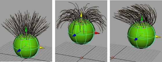

You can easily add springs to strokes with tubes to give the tubes reactive, interconnected motion. By animating the movement of the surface with the springed tubes on it, the tubes will react appropriately.
When you add spring behavior to a stroke, Paint Effects creates an expression that makes the tubes behave like springs. You can edit this expression in the Expression editor.

    To see the effect of the spring, move to a frame after the Start Frame (at least two frames after) and transform the object. For example, if the Start Frame is set to 2, move to frame 5.
  3. Switch to the scene view, if you are not already in it, and keyframe the movement of the surface. For details, see Animation in Maya.
  4. Click the Play Forward button to check that the tubes are behaving the way you want them to.
