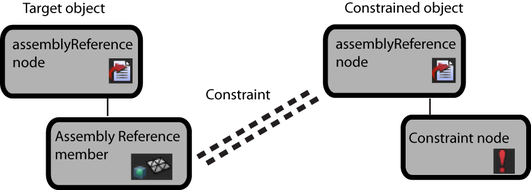

Example 2: Target object is an assembly reference member and constrained object an assemblyReference node
Use-case
An assembly reference of a prop object, such as a flashlight or crowbar, is constrained to the member of another assembly reference. When the character is animated, the prop remains in the character's hand.

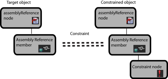

Example 3: Target and constrained objects are assembly reference members
Use-case
An assembly reference member, the hand control of a character rig, is constrained to an assembly reference member of another assembly reference, which is the steering wheel of a car model. When the wheel is turned, the character's hand remains attached to the wheel.

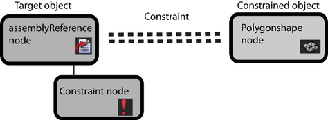

Example 4: Target is an assemblyReference node or an assembly reference member and constrained object is a main scene Maya object
Use-case
A main scene object, such as a user-defined camera, is a target object that constrains an assembly reference member, such as a part of a cruise ship model. When the ship model moves or rocks back and forth, the camera remains fixed and tracks the ship's motion.
