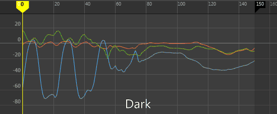

Themes are preset color and view settings that let you change the appearance of the Graph Editor to fit your workflow. There are five themes: Dark, Light, TRS Distinct, Colorblind Compatible, and Classic.
Each of these themes are designed to provide you with a balanced and accessible workspace. You can further customize any of these themes by adjusting the color preferences.
